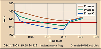

Power monitoring data captured at numerous locations across the affected area was useful in understanding the full cascade of events, notably the escalating series of voltage sags, as shown in the accompanying recorded plots. In fact, customers who used monitoring systems could recognize the unique signature of the simultaneous 3-phase deep sag and were able to affect an orderly transition to their UPS and backup systems.
At about 3:45 p.m., a fault apparently occurred on the transmission system. The 8-cycle voltage sag, shown in Fig. 1, was measured at an industrial site in Cleveland. One explanation for why this fault occurred is that the lines overheated from excessive current brought on by load transfers, which resulted from preceding line and generator tripping. Overheated lines elongate and can sag into trees or other structures and lead to a short-circuit fault. The fault was detected and cleared promptly, but the voltage recovery at the site appears to have been slow, suggesting that the system was now much weaker. At least one more line was out of service.
Shortly after 4 p.m., another instantaneous voltage sag was recorded, and the plot shows that the voltage drops abruptly and remains at the lower level (Fig. 2). Phase unbalance developed, suggesting either the presence of a remote fault or that the tripping of another line had caused the system to become very weak.
