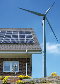

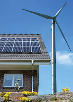

    The 2011 NEC added Art. 694, which applies to small wind (turbine) electric systems that consist of one or more wind electric generators having a rated power up to and including 100kW (see Figure below). Typical system components are a generator (or alternator), inverter, and controller [694.1] — see SIDEBAR: Where the Wind Blows.
    One way that wind differs from solar and fuel cell systems is physical access. The typical roof-mounting of residential and commercial solar means requires minimal climbing for the installers, but access to a wind system nacelle (where the generator or alternator is located) may require climbing a 75-ft tower.
    On larger towers, the ladders are inside the tower body. The towers of the smallest residential wind turbines (under 10kW) are really pole-mounted systems where you reach the nacelle from the outside of the structure.
    You need climbing safety training and climbing equipment to work on any but the very smallest of wind systems. You must be adept at completing elevated work as well. This means carefully planning each task and following procedures that prevent you from dropping your parts bucket onto the customer’s new pickup truck 75 ft below.
    Height is also a factor in the NEC requirements. Obviously, a disconnect in a nacelle 75 ft off the ground isn’t “readily accessible” as required by 694.22(C)(1).The language of 694.22(C)(1) specifically permits locating the disconnect at a readily accessible location either on or adjacent to the turbine tower, on the outside of a building or structure or
    inside, at the point of entrance of the wind system conductors.
