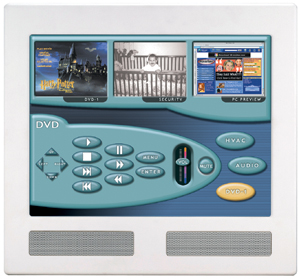

User interfaces.
Integrated user interfaces can encompass computer terminals, wall switches, or cell phones. Although integrated systems can have multiple user interfaces, the primary motivation behind the integration of multiple systems is the capability to have a single user interface through which all major home systems may be controlled.
Many installations use a Microsoft Windows interface for control of complex integrated systems. Microsoft Windows XP is one such user interface. Windows XP makes home automation simpler for the homeowner to manage because it's familiar to many existing computer users. Windows CE is designed for implementation on mobile, handheld, and other space-constrained devices that are suitable for deployment as automation controllers.
Wall switches and panels are also popular choices for installations because they offer immediate control, typically at the point of use. In more complex interface systems, you must ensure that input from one device is reflected to other input mechanisms in order to avoid potential conflicts.
Handheld remote control units are common for integrated automation applications. These devices frequently provide the advantages of lower cost and easier programming, but these handheld devices can't offer the context-sensitive buttons and menus offered by a standard keyboard.
Complex systems must be controlled through interfaces that are straightforward, unambiguous, and easy to learn. One of the most common and effective methods is to combine multiple system states into complete scenes, combining lighting levels, HVAC settings, and A/V commands. It's important to build scenes and control combinations carefully, testing each controlled aspect fully before adding the next. Confusion between control points can result in unanticipated device behavior and unsatisfied homeowners.
