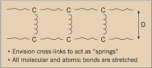

Although they're used for different applications, both types of tubing use the same material science of cross linking to achieve shrinkage. The materials that make up the insulation — ethylene propolyne diene monomer (EPDM) or silicone rubber in the case of cold shrink, and ethylene vinyl acetate (EVA) in the case of heat shrink — are cross linkable, which allows them to stretch and then shrink onto the cable.
In both cold shrink and heat shrink products, cross linking is a process that forms bonds that act like springs between the long-chain molecules of the material in the tubing; when the tubing is stretched those bonds try to return the material to its original shape (Fig. 1). The more these materials are cross linked, the stronger their desire to return to their original shape. The distance that the material stays expanded beyond its original diameter is called permanent set.
The manufacturer provides an application range that takes into account the permanent set of the material (Fig. 2). This application range will ensure continuous inward pressure during the life of a cold shrink product. Because of this living seal, cold shrink is best-suited for situations where large load swings or temperature differences occur. As the cable expands and contracts with these differences in temperature, the cold shrink product will expand and contract with the cable to maintain a tight seal.
