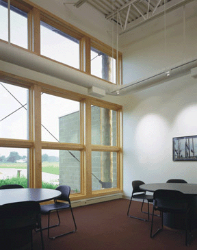

College dining hall project. Large windows on three sides of the room and high diffuse glazing on the south side were supposed to provide daylighting. The south windows had a deep interior light shelf, which functioned as a shading device. Photosensors were placed near the windows, linked to controllers by zone and a central control system. However, non-dimmable lighting systems were connected to the dimming system. Control zones were not matched to daylight patterns. The circuits were not wired as shown in the construction drawings, and the photosensor was not calibrated during construction, resulting in lack of detection of the wiring errors.
After noticing the problem, the staff called for calibration. The control system was reprogrammed as switching instead of dimming. In some cases, the control zones matched the daylight pattern, and the problem was resolved easily. In others, the control zones did not match the daylight, which resulted in rewiring work.
