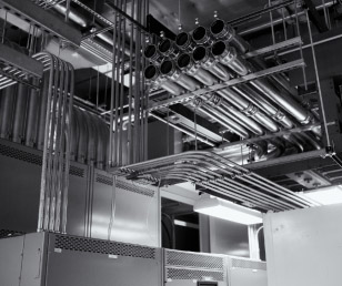

As we continue to discuss the take-off, the most material-cost-intensive part is the feeders. Pay special attention to wiring methods. Most of the time, you will be providing copper conductors — either in polyvinyl chloride (PVC), electrical metallic tubing (EMT), or galvanized rigid conduit (GRC), depending on the application.
If the general contractor (GC) requests you to use aluminum wire, you will have to upsize the wire and conduit sizes, because aluminum wire does not carry the same ampacity ratings as copper. Make sure the panel will accept the upsized wire. Although the NEC may state that you can use aluminum wire under certain conditions, the local code or the building’s standard may not. Confer with the AHJ if there is any doubt. Look at the riser. Often, engineers upsize the conduit. If the project is a public bid opening, you should price exactly what you see on the drawings. However, for private jobs, you can size the conduit to Code — but make sure you qualify this in your proposal.
