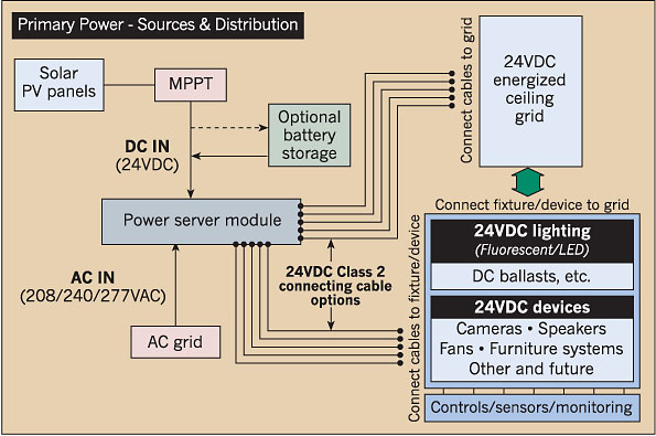

Fig. 1. Load devices optionally connected directly or indirectly to the PSMs.

A full system covered by Art. 393 includes:
1. Low-voltage Class 2 power supplies (sources).
2. Low-voltage wiring, cables, and grid busses (interconnect).
3. Low-voltage common utilization equipment (loads).
Starting with power sources, the key component is the power server module. A power server module (PSM) is typically configured to have between one and 32 channels of low-voltage Class 2 power output. The power source for the power supply can be either AC or DC, depending on the upstream power system configuration. In systems that are converting line current AC, the input AC is typically between 240VAC and 277VAC. In systems that use direct feeds from on-site alternate energy sources, such as solar, wind, fuel cell, and other native DC generation, the input voltages are typically in the 350VDC to 400VDC range. DC inputs eliminate the DC to AC conversion losses typical in AC distribution systems. Many PSMs have integrated control and other power management features, including branch switching and monitoring/dimming. These features can be extremely useful when “always-on” power is not required on some channels. Communication to the PSM can be wired or wireless and may include such protocols as ZigBee, IPv6, 0V-10V, Modbus, etc. The interconnect (wiring) components include:

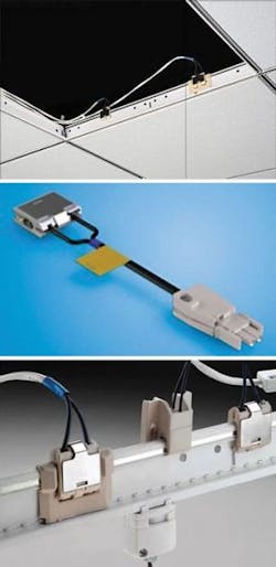

Typical commercially available interconnect components.
1. Grid bus
2. Power feed cables
3. Power load cables
The ceiling grid mounted bus component provides flexible plug locations for the power load cables, but has fixed position connections for the power feed cables to control total wire lengths that limit low-voltage wire loss. A variety of actual interconnect components available from suppliers are depicted in the group of Photos to the right.
Specially keyed connectors on the power feed cables used between the PSM and the grid bus prevent the bus from being over-powered. This is an important feature of the system and should not be overridden or tampered with, or the system may end up in violation of the NEC.
