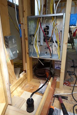

Tiny houses are often wired for electricity the same way average houses are with the exception of the incoming power connection, which is typically a 30A or 50A RV plug, says Greg Parham of Rocky Mountain Tiny Homes, Durango, Colo. However, some tiny houses require a hard-wired connection to an electric utility pole or via underground conduit if they use high-draw appliances, he says. Because most tiny houses are on mobile foundations, they often end up in RV parks, where they usually connect to a 50A max service. Alternatively, if they are situated in a backyard, they will be limited by what service they can tie into at the main house, but it’s normally 40A to 60A.
“It’s fairly uncommon right now for people to be able to hook up to more amperage,” Bezdek says. “So most of the homes have relatively small service panels with 8 to 16 slots.”
Also, unlike residential houses that space out outlets every 8 ft, Ryals says most of the tiny houses she works on place outlets every 6 feet, if possible.
Tiny House Systems designs all tiny houses on trailers to be RVs because they are not houses, as set forth by the IRC, Bute says. As such, the RVs designed by his company use 12VDC appliances like a water heater, furnace, water pump, and lighting to be compliant with the NEC.
To illuminate a THOW, Bute says his team designs 12VDC LED lighting systems and uses small ribbon strips and pucks throughout the house. In addition, they specify standard residential decorative luminaires for the bathroom and a screw-in, medium-base 12VDC LED type lamp.
“Using 12VDC lighting and a 12VDC power system eliminates the need to find space for the LED drivers and allows for a smaller wire to be used,” Bute says.
With both tiny houses on mobile and stationary foundations, Bezdek says his company follows the International Residential Code, which is in effect in Austin for single-family residences.
“Really, there is no difference in electrical wiring from a large home, although because the homes are small, we usually upsize the wiring,” Bezdek says. “If an appliance, for instance, can use 12-3 wiring, we will go ahead and use 10-3 because the runs are short, and wire is not nearly the same cost factor as it would be wiring a larger home.”
