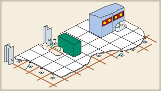

For increased density within the ITE area, a nested CBN can be intentionally “meshed” by the manufacturer(s) or end-user onto the ITE at the deployment area. This variation is known as a mesh common bonding network (MCBN or MESH-BN) and is typically designed into the ITE complex by means of metal racks, cable tray, raceway, etc. The MCBN can be arranged for installation under the raised floor, at the floor level (metal structure of the raised floor), or above the cabinet or rack (i.e., superstructure). You can also describe such structures as mats.
Figure 1 (click here to see Fig. 1) illustrates an MCBN superstructure arranged for both under-floor and at-floor level installation. This superstructure is effectively a “dual entity,” as it depicts inter-bonding at several stanchions. Essentially, they can be considered single superstructure entities. The under-floor superstructure is a grid network of copper conductors that may be within a few inches of the at-floor level or placed onto the under floor, which is usually concrete. The at-floor superstructure is a grid network comprised of the raised floor stanchions, stringers, and, to some extent, the panels. Usually, the at-floor superstructure is supplemented by the under-floor superstructure due to construction issues in maintaining proper grounding and bonding or for improved access for connecting to the ITE.
The figure also illustrates some important points and raises some concerns. First, the raised floor stanchion-and-stringer system is usually not considered robust enough (mechanically and electrically) to stand alone as an MCBN superstructure. Second, the under-floor copper grid is intended to improve the electrical capability of the at-floor metal grid. Third, both the raised floor stanchion and stringer system, and the under-floor copper grid must be inter-bonded at least once (for safety). Typically, they are inter-bonded periodically (for performance) within the grid pattern. Finally, the perimeter of the MCBN superstructure grid can be distinguished as a ring-bonding conductor (RBC) to provide placement for easy attachment to the CBN [such as at the T(M)GB].
