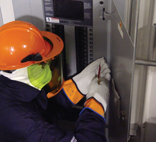

Many facilities use infrared scanning as part of their maintenance programs. These activities require workers to perform tasks while equipment is energized and most likely exposed. Many times, this type of work requires the worker to open and remove covers, and then replace them when the task is finished. As the designer, you can reduce these hazards by specifying strategically located UL-approved infrared windows in major equipment and switchgear.
