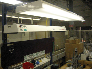

One solution is a simple strip fixture over the inspection station with a local switch to boost light levels only where and when it's needed (Photo). Improving on this simple approach, you can also install an occupancy sensor at the station for automated control. In fact, some may argue that task lighting was invented for industrial applications — the task light on the band saw was probably in service long before the task lights in office cubicles.
