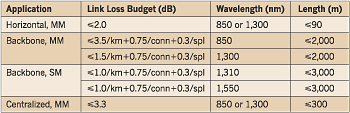

Look to the standards for help. Part 1 (General Requirements) of TIA/EIA-568-B.1 “Commercial Building Telecommunications Cabling Standard” rates the quality of a link based on several performance characteristics. This classification or definition of quality, based on the performance characteristics for horizontal, backbone, and centralized applications that are listed in Table 1 is widely accepted throughout the industry. BICSI has adopted this definition and references it in the organization's Telecommunication Distribution Methods Manual (TDMM).
The fiber link test procedure consists of three steps:
  • Measure the optical link loss at the appropriate wavelength(s) as dictated by the application and fiber type.
  • Measure the link length.
  • Compare the results to the link loss budget, which represents the uppermost limit above which a fiber is considered no longer usable.
