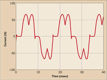

From the viewpoint of the utility-supplied power system, the typical 6-pulse VFD, which is a nonlinear load, draws a distorted current like the one represented by the waveform in Fig. 1 at right. This waveform is very rich in 5th and 7th harmonics and contains lesser amounts of the 11th and 13th harmonics. Higher order harmonics are present in smaller quantities and only cause problems in rare cases where high order resonant conditions exist in the system.
