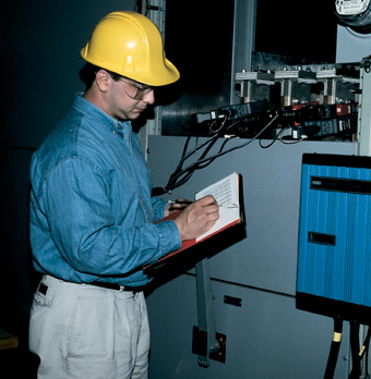

Specifying. Someone must provide a testing specification to identify the scope of work and responsibilities. Regardless of what the testing specification implies or directly states, the NEC requires performing certain tests prior to energizing particular systems. For example, 230.95(C) requires performance testing of ground fault protection systems. Specifications should include a detailed equipment list, specific tests required, references to applicable codes and standards, and site-specific data sheets. Maintenance departments can benefit from doing spot checks (Photo) before finalizing the specification so they can repair minor problems and identify testing needs they might have overlooked. A Tennessee appliance factory discovered grounding anomalies during their pre-testing checks and was able to schedule ground testing during a shutdown originally planned just for switchgear testing.
