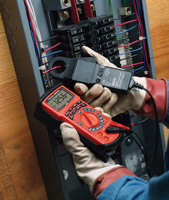

So you want to know the load on a 400A breaker that's experiencing frequent nuisance trips? If you don't already own a current clamp (Photo 1 above), you'll need to buy one, but before doing so, make sure it and your meter carry the proper category rating. In this case, it would be at least Cat. 3 and 600V. If you don't own such a device, spend the money to buy a meter capable of that measurement, rather than combining a meter and an accessory.
