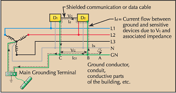

How do these problems occur? Let's look at Fig. 1 (right), a schematic of a grounded 3-phase system. Note the grounding circuit is bonded to the ground at one location: the main grounding terminal. Note also the other two grounding conductors leaving the main grounding point. One goes to the neutral of the main and other transformers in the system. The other is in the form of the conduit, a separate grounding conductor (so called isolated ground), and the conductive parts of the building.
Concentrating on Point A of Fig. 1, you can see the neutral conductor makes contact with ground. This causes the return current flowing from the load to be partly diverted from the neutral conductor to the grounding conduit as well as conductive parts of the building. The amount of the return current divides according to the paths' impedances. This partial (it could be a complete) diversion of current between the neutral conductor and the grounding network causes the problems we discussed earlier.
Yes, there's a certain amount of normal leakage current going from the neutral and the phase conductors to ground in all electrical systems. Usually, the level of this leakage current is from about 10mA to some 100mA, depending on the size of electrical system.
Voltage differences are between different grounding points. Let's assume we have two sensitive electronic devices, say a remote measuring probe and a PLC system, as shown in Fig. 1. (Let's call them D1 and D2 respectively.) Note these devices are connected to different parts of the electrical system. Between the electronic devices is a communication cable, which is shielded. This shielding is grounded to the grounding circuits of D1 and D2.
Because of contact between the neutral and ground at Point A, the return current flowing from the load also flows through the grounding network and the grounding circuits in Devices D1 and D2. And each device's cabinet, which is insulated from the internal working electronics, connects to the grounding conductor.
This return current causes a voltage (VsubG) between points B and C. This voltage is also present at the cabinet of each device. A voltage in the grounding conductor and associated impedance causes current (IsubD) to flow in the communication cable between Devices D1 and D2. This current may disrupt their operation because the voltage difference and resulting current are often quite high.
