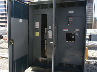

A fault current of 62,321A is calculated at the switchgear. This value is based on the 2,500kVA utility transformer with 4.775% impedance and minimal impedance from the service conductors (11 feet of 10 sets of 600 MCM copper).
The simple form of this calculation, based on infinite bus theory, is indicated below:
2,500kVA÷(√3×480V)÷0.04775=62,975, or 63,000AIC at the utility transformer secondary
However, the AIC is further reduced at the service to 62,321A, based on the impedance of the service conductors. This assumes no contribution from the motors in the system or from the asymmetric component.
If the switchgear is rated based on this information only (i.e. no X/R or motor contribution), the switchgear could have easily been specified as 65,000AIC.
In this example, we're looking at a total contribution of 400 hp for the motor and an X/R ratio of 11 at the secondary side of the utility transformer. The X/R ratio at the switchgear is calculated at 10.37 based on the X/R ratio at the service transformer provided by the utility and the contribution of resistance from the service conductors and the reactance from the motors in the system. The electrical service equipment has been tested and rated at an X/R ratio of 4.9. The calculation of this X/R value can be performed using sophisticated software, electronic spreadsheets, or by long per-unit handwritten calculations. However, this work is beyond the scope of this article.
The motor adds a total of about 2,406A of fault current over the first half cycle. The motor contribution is based on the characteristics of the individual motors, but can be estimated by taking the total horsepower contribution, multiplying it by 5, and then converting this number to amps.
The high X/R ratio requires the de-rating of the gear by a factor of 1.139. The 1.139 is a multiplier factor equal to the asymmetric current at the calculated X/R ratio divided by the asymmetric current at the tested X/R ratio.
In addition, the following formula can be used to calculate the multiplier factor based on the calculated X/R ratio and the test X/R ratio for a given overcurrent protection device:
In this case, the total fault current available, including the motor contribution, would be 64,727A.
62,321A (symmetric fault current)+2,406A (motor contribution)=64,727A
The gear, based on asymmetric de-rating, would be rated at 57,068A.
65,000A (gear rating)÷1.139 (X/R derating factor)=57,068A
Assuming that the simplistic form of fault current calculations was initially used to size and install the main switchboard, the switchgear would have a fault current rating lower than the maximum available short circuit current and would therefore have to be replaced.
