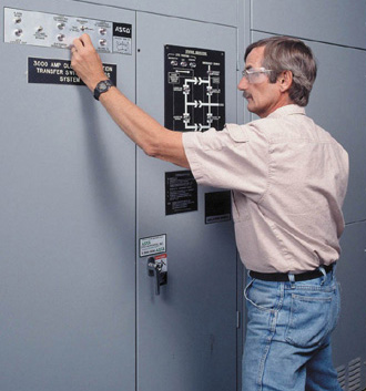

Ground and switch the neutral. When the service falls under 230.95, you should ground the neutral at each source and switch it where the Code requires ground fault detection coordination. When the service rating equals or exceeds 1,000A (833kVA), 230.95 requires ground fault protection on the service disconnect. What if your load is important enough to justify an alternate power source and transfer switch (Photo)? In that case you may want to expand the ground fault protection scheme to second level branch circuit protection, according to 230.95(C), FPN No.2.
When the NEC requires ground fault protection and you have an alternate power supply, you must switch the neutral. If you have a service larger than 1,000A, the NEC requires ground fault protection at the main service disconnect. If the generator neutral grounding runs via a solid connection to the main service neutral and the generator experiences a ground fault while feeding the load, the main service disconnect will open. This will not disconnect the arc fault from the generator, and coordination will be lost.
If the neutrals of the two sources are separately grounded, you must switch the load neutral conductor to the source feeding the load, per 230.95(C) FPN No. 3. Ground fault current will return only to the source from which it originates, providing for coordination of the ground fault protection scheme.
