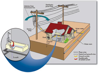

Contact current. Contact current is current that flows within a person when two locations on that person's body are in contact with electrically conductive surfaces at different electrical potentials, or voltages. For example, if the thumb and forefinger are in contact with the top and bottom of an ordinary AA battery, a small current will flow in the loop created by the fingers and the battery. If the fingers are dry, the current will be relatively small, as dry skin has a high electrical resistance; with wet fingers, the moisture will breach the skin's insulation, lowering its resistance so that comparatively more current will flow. Likewise, contact current can travel through portions of the body from one hand to the other or to a foot, should those extremities be in contact with surfaces of different voltages.
The issue of contact current safety goes back to well before the EPRI program became involved with this exposure in terms of the EMF health issue. Underwriters Laboratories, a Northbrook, Ill., not-for-profit product safety testing and certification organization, specifies limits for leakage currents from home appliances of 0.5 to 0.75 milliamperes (mA), depending on the device; the National Electrical Safety Code limits exposure to 5mA in the rights-of-way of high-voltage overhead transmission lines; and guideline-setting bodies, such as the International Commission on Non-Ionizing Radiation Protection and the Institute for Electrical and Electronic Engineers, recommend contact current limits of anywhere between 0.5 and 1.5mA, depending on exposure circumstances. All of these limits are intended to reduce the chance of annoying or even hazardous startle or pain reactions to the exposure. EPRI's EMF research deals with lower exposure levels, which fall below the threshold of sensory perception.
Since 1999, Robert Kavet, program manager for EMF health assessment, has led EPRI's research on contact current as a factor that could explain the association of magnetic fields with childhood leukemia. Actually, the idea of a possible role for contact current in EMF health studies occurred to Kavet in the late 1990s, after the publication of several studies suggesting that one's occupation as a seamstress or tailor was a risk factor for neurodegenerative disease; the studies' authors attributed their results to magnetic field exposure from sewing machines. Kavet visualized the machine operators' manual contact with the machines through an entire workday, and with a quick back-of-the-envelope calculation, Kavet realized that the dose of electricity in the body from contact current, particularly in the extremities, would dwarf the doses associated with magnetic fields from the machines. This line of research led to the development of a personal meter to measure occupational exposures to contact current; the meter was put to work in an EPRI study that reported that occupational exposures to contact current would be more likely to occur when equipment was poorly grounded. At about the time Kavet was considering occupational scenarios, thought was given also to the possibility of residential contact current exposures in children vis-à-vis the childhood leukemia connection with magnetic fields.
How would a child be exposed to contact current in a residence? The most likely exposure, according to EPRI's research, results from grounding practices intended to provide electrical safety and fire protection. In the United States, the National Electrical Code has required that a residence's electrical service be grounded to an available metal (electrically conductive) water pipe within the residence since 1918. As a result of this grounding connection, a small neutral-to-earth voltage — usually less than 1V — will appear on the water pipe, arising from household currents returning via the water pipe back to the substation or from induction on the neutral system from nearby sources of magnetic fields, such as overhead transmission lines or heavily loaded distribution primaries. This voltage will extend across all contiguous elements of the water system, including the metal water fixtures in a bathtub, sink, or shower (Figure). If the drainpipe sunk into the earth under a bathtub, sink, or shower is also made of metal, a bathing child touching the faucet or water stream will receive a contact current into the arm and through the body; in all but very extreme cases (for example, cases where there is a broken ground connection), these exposures are imperceptible, even to a small child. The current pathway includes the bone marrow (the site of leukemia development), with the highest dose expected in the thinnest extremities, where the current densities must be the greatest — that is, in the lower arm and hand.
