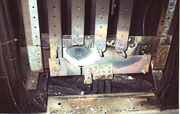

When switchgear malfunctions, the consequences are often catastrophic. Damage to the switchgear itself can be extremely expensive, but that pales in comparison to corollary damage and the potential hazards to people. Thus, implementing an effective switchgear testing, inspection, and maintenance program is essential. Even switchgear labeled “maintenance free” requires periodic testing and maintenance.

Switchgear maintenance is usually considered a low priority by most management teams, who defer or ignore it until a failure occurs. At many facilities, the maintenance crews take only some of the easier steps. However, experience shows this is an economic dance with the devil. When you fail to conduct the proper maintenance, the risk of loss is high. But a solid maintenance program is much less costly than the impact of switchgear failure, which can include injury or death, lost product and production, as well as clean-up and switchgear replacement costs. When you give maintenance the thought and effort it deserves, you improve safety, reliability, uptime, and profitability.
