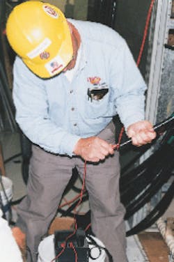

There are some low-end insulation resistance testers in existence that have features and specifications similar to those of more industrial models, so you may think your low-end unit is well-suited to the work you need to do. And maybe it is. But if it isn’t, you could endure injury, lost time, incomplete testing, and recurrent downtime. Like all test equipment, insulation resistance testers (photo) require you to do some research before deciding what model to purchase.
