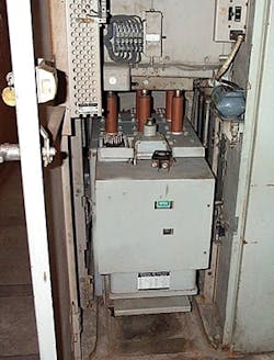

Photo 1. Typical CB in the “racked-out” position.
Most large (high-energy) circuit breakers (i.e., 480V to 13kV) are installed in metal compartments and can be racked-in, racked-out (Photo 1), racked to test position, and completely removed from the compartment. These CBs typically control high-energy equipment and are capable of containing an arc flash if operated and maintained properly. If performed improperly, however, racking-in or racking-out a CB can be a very dangerous task.
CBs can be racked-in horizontally or vertically. The racking mechanism usually activates a built-in shutter/barrier that exposes the ports in the CB compartment while the CB is “racked-in” and covers the ports while the CB is racked-out. You should always follow the manufacturer’s instructions for racking-in, racking-out, or removing a CB from a compartment. Remember, working in a CB compartment with the unit completely removed can result in catastrophic consequences if approved safe work practices are not followed. So how do you protect yourself from the dangers associated with this type of work? By following a strict set of work procedures and safety practices.

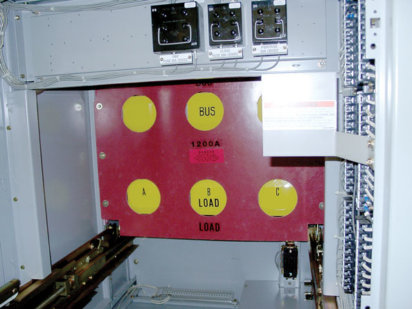

Photo 2. Relatively new CB compartment with CB removed and built-in shutters covering all ports.
Typical 3-phase CB compartments contain six ports. When the CB is removed from the compartment, you shouldn’t have access to any of the ports because the shutter mechanism is designed to cover all of them (Photo 2). But how do you know which ports are bus, line, or load? I’ve worked in facilities that used a variety of terms to identify these ports, including “bus” and “line,” “line” and “load,” “bus” and “load,” “upper” and “lower,” and “front” and “rear.” In some facilities, many CB ports have no identification at all. When faced with this situation, it’s up to you to determine the meaning of these terms. When working in a CB compartment, you should adhere to the following requirements:

Because complete isolation usually involves shutting down the entire bus section, many electricians, engineers, and supervisors chose to work in the CB compartment while the bus is energized, but this can have fatal results. The quick and easy way to conduct tests on the power distribution system components is to remove the CB from the compartment and take measurements through the appropriate ports. But how do you know which ports are the appropriate ones? Is it the “bus,” “line,” “load,” “front,” “rear,” “upper,” “lower,” or unmarked port?
Keep in mind that it’s not only the main power feed that can harm you. In addition to the primary power inside the CB compartment, the control circuit power and power that supplies compartment alarms, relays, and heaters could also injure or electrocute you.
As noted earlier, when you remove a CB from its compartment, the shutter/barrier mechanism covers all of the ports to prevent access to those that are still energized. The manufacturer had good reason for such a design. However, you’ve probably also learned how to expose the ports by operating the CB racking mechanism without installing the CB, which will expose six ports. Three are energized, and three are de-energized. Do you know with certainty which ports are de-energized? If you’re working in a tie CB compartment, all six ports are energized.
As discussed earlier, if the ports are marked (many have no identification), you must first determine the meaning of the identification. Your life — and the lives of those in the vicinity of the compartment — are at risk if you make a mistake. If you wear appropriate personal protective equipment (PPE), you markedly increase your chances of avoiding serious injury, even if you make a mistake.
If you know that three ports are energized and three are de-energized, you should use an appropriately rated voltage detector to check for the presence of voltage. It may be difficult to find a high-voltage detector that includes a probe that will make sufficient contact with the recessed conductive parts inside the ports of a CB compartment, but it may be possible to work with a manufacturer to develop a custom unit.
Once you have properly identified the de-energized ports, you must obtain a “safe” probe for your insulation tester or other test equipment to make contact with the de-energized conductive material that’s inside the de-energized ports. Remember, if you inadvertently insert the probe into the energized ports, there’s a high probability that you will be electrocuted or seriously burned.
