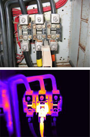

It is common practice for most electricians to tighten mechanical set-screw connections without a torque wrench. Many qualified installers believe they know how much to tighten set-screw connections without using a torque wrench, because everything works fine once the system is energized. What they rarely see is what happens a year or a decade down the road when a connection that was not properly installed begins to overheat and fail (Photos). Then, the service electrician comes in, repairs the problem, and tightens the new connector — once again, without a torque wrench. These electricians aren’t intentionally doing inferior work; they simply don’t understand how important correct torque is to the safety and long-term integrity of the electrical system.
It’s estimated that 90% of electrical failures occur at connections. To determine how accurately installers tighten set-screw connectors without a torque wrench, a test assembly was designed using aluminum bar stock and aluminum tin-plated mechanical terminal lugs.

According to the 2007 paper, “Connector Theory and Application: A Guide to Connection Design and Specification,” produced by FCI USA, Inc. and authored by Gary Di Troia, Kenneth Woo, and Gaylord Zahlman, over-tightening a set-screw connection does not increase its reliability. It can, however, damage the lug or the equipment to which it is attached. It can even break conductor strands. Under-tightening connections can lead to overheating and failure at the connection.

So why don’t we have more failed connections if most electricians appear to be doing such a poor job of tightening them? The fact is that our electrical system has built-in safety factors, and circuits are rarely fully loaded. Lightly loaded circuits put less stress on weak connections, so they may perform satisfactorily for many years before experiencing a problem, if ever. However, this is no justification to ignore basic installation instructions. The bottom line is a torque wrench is an easy and inexpensive way to improve the reliability and safety of an electrical system.
