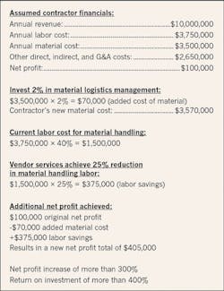

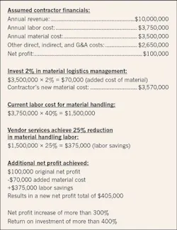

Lowest installed cost does not mean cheap. In fact, paying more for the material can actually improve a contractor’s profit margin.
The basic premise of lowest installed cost is that a contractor can manage the trade-off between material cost and labor savings to provide greater value to the customer, greater sales to the supplier, and greater profits to themselves. Another way of viewing this is the return on investment in vendor services. With an efficient partnership, based on mutual understanding of each other’s business needs and operations, finding a win-win solution is not only doable, but also almost unavoidable. The calculation below shows the return on a modest 2% investment in material price resulting in a willing vendor partner helping the contractor to reduce material handling labor costs by 25%.
