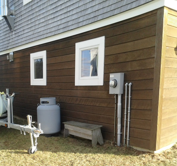

Photo 1. Typical electric meter location in flood zones may violate present FEMA regulations if first floor living space begins where shingles are located.
Photo 1 shows the typical location of an electrical service on a house located in a FEMA VE flood zone. Note that it’s located according to utility standards — typically 3 ft-6 in. to 5 ft-6 in. to the centerline of the meter above grade. However, the first floor living space begins where the siding is grey in color. In this case, the home’s main electrical panel is located back to back with the electrical meter socket box, which means flooding with salt water would probably result in complete replacement of this panel and relocation to a higher elevation after a future flood. Replacement and relocation costs would be very expensive with this equipment.

So what’s an installer supposed to do? The key is to follow the elevations required by the local building officials in the area the house is being built. For the application of utilities, it’s best to allow for a slightly higher minimum elevation of at least 1 foot above the DFE level set by the authorities and obtained from the local building official.
Electrical contractors working in these types of scenarios need to ask if the property they are working on is located in a flood zone and then adjust accordingly. Referring to FEMA’s “Home Builders’s Guide to Coastal Construction” technical fact sheets and consulting with local building officials is a good start. Most utilities only provide the wire for new services from the pole to the meter box located on the house or underground to a free-standing meter location. Therefore, the contractor can influence the utility location of the meter by referring to FEMA requirements.
