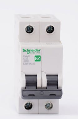

Schneider Electric 32A double-pole circuit breaker.

One issue that has been seen lately is the use of AWG conductors being protected from overcurrent by International Electrotechnical Commission (IEC) rated breakers. For example, a common size of small circuit breaker in the IEC world is a rating of 32A (Photo). So the question becomes, what is the minimum size AWG copper conductor allowed per the National Electrical Code (NEC) for this size breaker?
It seems to be a common misconception that a 10 AWG copper wire can be used on a 32A breaker. After all, if you look at the 75°C column in NEC Table 310.15(B)(16), the conductor is rated at 35A. However, the double asterisks in the size column for 10 AWG needs to be noted, and it’ll direct you to Sec. 240.4(D).
Section 240.4(D) states: “Unless specifically permitted in 240.4(E) or (G), the overcurrent protection shall not exceed that required by (D)(1) through (D)(7) after any correction factors for ambient temperature and number of conductors have been applied.” 240.4(D)(7) shows 30A for 10 AWG copper. The 35A rating can be used only for applying derating or ambient temperature adjustments.
So, protecting the 10 AWG solely with a 32A breaker is a violation of the NEC. The 32A breaker is rated 6.67% higher than allowed by Code. An 8 AWG (minimum) copper wire would need to be used in this case.
