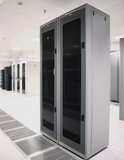

These power measurements provide a baseline that allows an IT facility manager to compare his or her power usage levels to other data centers. Typical components found in a data center are shown in Fig. 1.
