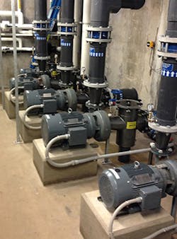

Industrial motor installations often provide great opportunities for energy savings. The typical industrial motor lasts a long time — often several decades — so an investment in energy reduction can add up to serious money during the lifetime of the installation.

Motor selection. An energy-efficient motor costs more than its counterpart, but over the life of the motor the difference can pay for itself many times over. Thus, replacing a perfectly good standard motor with an energy-efficient one may make financial sense. Make sure you also choose the correct motor for the application (e.g., Design B if that’s appropriate, correct insulation rating for the temperature, etc.).
