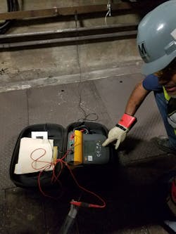

But WMATA faces a formidable task in hunting down and fixing the conditions that lead to electrical arcing. Despite the plan to take it in small bites, inspection and testing is tedious and time-consuming — even more so on a busy and vital commuter rail line.
Since insulation resistance and stray current testing require complete de-energization, and can’t be done in a way that cuts power to only one track in the two-track system, work will have to be compressed into off-peak hours. Late-night service will be cut back to open a bigger window for the work, but crews will still be under pressure to move methodically but determinedly through the process of cutting power, setting up and performing tests, collecting data, and restoring service. Plans call for all sections of the line — cables feeding the third rail that powers the trains and the negative, return side that carries electricity on a circuit back to substations — to be analyzed.
“There are a lot of places where we don’t have a visual on the cables, so pursuing a visual inspection plan won’t give us a full picture,” Off says.
The testing itself can be done rather quickly, Off says, but setup and repeating the process for each section is time-consuming.
“The technique itself hasn’t changed much in 40 years, and there’s not much to it in terms of equipment,” he says. “The act of using the instrumentation represents a fractional minority of the total time needed to carry out the activity, which involves scheduling the work, disconnecting the rails, making sure it’s performed safely, collecting results, and producing a report on what actions we need to take.”
Follow-up action on the test results will depend on a number of factors, most importantly how extensive the leakage is and how likely it is to produce arcing. Off says WMATA will generally be guided by a set threshold for insulation resistance; if there’s failure, corrective actions up to and including replacement will be made.
