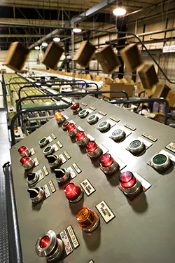

A large piece of production equipment has all of its controls in a central cabinet. The cabinet is fed by a 40A branch circuit. Many other types of equipment are on branch circuits originating in the panel where that 40A breaker is installed.
Photo credit: Jupiterimages/Stockbyte/Thinkstock
The preventive maintenance (PM) procedure for this system includes the step of using a digital multimeter (DMM) to record the supply voltage to the cabinet. Another step involves recording the supply voltage to each of the motors that are part of this system. They range from 5 HP to 50 HP. Three of them are VFD-controlled.
Do you see a problem here? Think about the process of taking a voltage measurement in an industrial setting. Is there any reason to expose a maintenance person to the hazards involved? And what are you going to do with the data?
Voltage measurements taken at the supply of a motor raise issues that require more than a DMM. For example, what’s the power factor when the motor is running? It gets even more complicated with a VFD in the mix (a power analyzer comes in handy, here). But for the purposes of maintenance (as opposed to system optimization), time would be better spent conducting infrared thermography on the motor system.
Consider the issue of measuring the voltage at the supply of the control cabinet. It’s not necessary. If the indicating lights of the individual controllers are on, the cabinet has power. If there’s a reason to know the exact voltage (really, you’re going to trend that perhaps?), install a voltmeter on the panel or have the PLC pick up that voltage and display it somewhere. If this cabinet is for a critical operation, you might want that circuit added to your power monitoring system.
