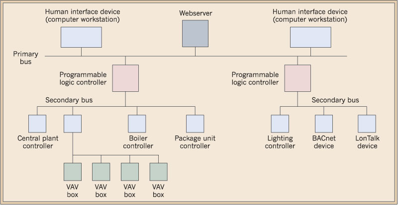

BAS defined
The word “automation” is key when describing a building automation system. The word is derived from the word “automatic,” which is simply defined as having the capability of starting, operating, moving, reporting, and/or shutting down independently. Another definition for automation in this field can include using various control systems for operating equipment such as machinery, robotics, and other operations with minimal human interaction.
A BAS incorporates many different types of automation, such as discrete control (on-off), continuous control, open and close loop, sequential control and logical sequence, or system state control and computer control. A BAS is simply defined as the automated control of the various equipment and systems that make up how the building operates on a day-to-day basis for the comfort and safety of the tenants and the efficiency of daily operations. This includes heating, ventilation, and air conditioning (HVAC), fire control, boilers, lighting, and any other systems (or sub-systems) that affect the building’s water, air, gas, electricity, and steam supply sources. The Figure (click here to see Figure) shows a simple BAS architecture.

A significant value of a BAS is its ability to provide building owners, facility, and sustainability teams with the real-time information required to drive efficiency of daily operations and reduce the costs of utilities and energy. However, you can’t change what you can’t measure. Therefore, there is a need for visualization, monitoring, and reporting prior to developing control strategies and continuous improvement initiatives.
Effective BAS visualization offers the ability to “tell the story” of building performance to management, engineering, building operators, and executives. Visualization in all BASs is provided via the collection of multiple data points — from field devices up through the BAS controllers. Once the data is collected, it can be transformed and parsed into actionable information that can be displayed on a computer screen(s), graphical user interface (GUI), and smart devices like phones and tablets. The same data can be used to develop and automatically distribute customizable reports for different rolls within the building management organization via text or email. From this data, a baseline is determined from which to measure the effect of any control changes or continuous improvement initiatives. This is where you can begin to see changes in utility and energy effectiveness.
