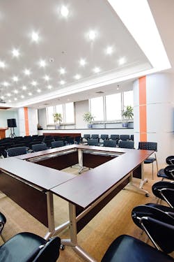

Photo 1. Lighting control systems play a critical role in reducing energy consumption in a building (lu linsheng/iStock collection/Thinkstock).
