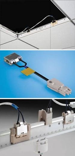

The ceiling grid mounted bus component provides flexible plug locations for the power load cables, but has fixed position connections for the power feed cables to control total wire lengths that limit low-voltage wire loss. A variety of actual interconnect components available from suppliers are depicted in the group of Photos to the right.
Specially keyed connectors on the power feed cables used between the PSM and the grid bus prevent the bus from being over-powered. This is an important feature of the system and should not be overridden or tampered with, or the system may end up in violation of the NEC.
