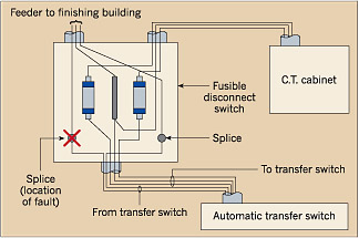

To answer this question, a comprehensive analysis of the electrical service was necessary. Electric service to the premises was 120/240V, single-phase, 3-wire from a pad-mounted transformer, owned by the electric utility company. The primary feeder to this transformer was underground, as was the 120/240V secondary feeder to the service entrance equipment of the farm. The secondary service feed from the transformer entered a current transformer cabinet and was then distributed to two fusible disconnect switches that served as the main disconnect devices for the entire farm. Two 3/0 copper cables with PVC insulation in the housing of a safety switch were connected using compression connectors.

Electrical repairs had been completed prior to the arrival of the plaintiff's investigator; therefore, the electrical system was operating normally. The plaintiff's expert found that the left splice on the load side of the wiring leading out of the fused disconnect switch (and providing power to the finishing building) had faulted to ground, prompting loss of 240V to the finishing building and causing the ventilation fans, which operated on 240V, to stop working. The location of the fault is shown in the Figure (sketch made by plaintiff's expert).
