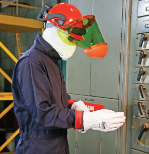

Qualified (authorized) group
This group represents your top-of-the-line, most technically skilled employees. In many cases, this includes the subcontractors you hired to do the more involved electrical work. These individuals have the highest exposure level to energized electrical equipment and need comprehensive training curriculum and skill sets (Photo 1).
NPFA 70E lays out a detailed list of requirements for those individuals who are at the highest level of exposure (click here to see Chart). Under 110.6(D), entitled Employee Training, parts (a) and (b) offer the following guidance as related to a qualified person:
“(1) A qualified person shall be trained and knowledgeable of the construction and operation of equipment or a specific work method and be trained to recognize and avoid the electrical hazards that might be present with respect to that equipment or work method.
  1. Such persons shall also be familiar with the proper use of the special precautionary techniques, personal protective equipment, including arc flash, insulating and shielding materials, and insulated tools and test equipment. A person can be considered qualified with respect to certain equipment and methods but still be unqualified for others.
  2. Such persons permitted to work within the Limited Approach Boundary of exposed energized electrical conductors and circuit parts operating at 50V or more shall, at a minimum, be additionally trained in all of the following:
    1. The skills and techniques necessary to distinguish exposed energized electrical conductors and circuit parts from other parts of electrical equipment.
    2. The skills and techniques necessary to determine the nominal voltage of exposed energized electrical conductors and circuit parts.
    3. The approach distances specified in Table 130.2(C) and the corresponding voltages to which the qualified person will be exposed.
    4. The decision-making process necessary to determine the degree and extent of the hazard and the personal protective equipment/job planning necessary to perform the task safely.”
We can simplify this reference with a quick “litmus test” as to the exposure of someone categorized in this group. Individuals who fit this category are expected to perform the following tasks:
  • Use a multimeter to troubleshoot a problem in an electrical device.
  • Use an approved voltage reading device to do a zero energy check in an effort to create an electrically safe work condition for themselves or for someone else to perform a needed repair or related work.
  • Any other task that would cause the individual to be exposed to energized or presumed energized parts of an electrical device.
Although this is not a complete list of tasks for this level, it should be fairly easy for you to whittle down the list of your employees who do not qualify for inclusion in this group. As you go through these steps, also be advised that you may quickly realize you have maintenance staff or mechanics doing work they really shouldn't be doing.
