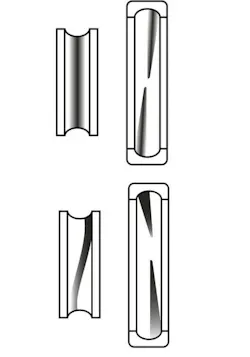

Diagonal wear paths indicate misalignment. The load zone of the bearing at top, shown as shadowed path, indicates that the outer race is misaligned to the shaft. The load zone of the bearing at bottom indicates the inner race is misaligned relative to the housing.

  • Misalignment. A diagonal wear path indicates misalignment (Figure).
  • Preloading. If the wear path is offset in opposite directions on inner versus outer race, the bearing was preloaded during service (Photo 1). Are both ends preloaded outward? That means the motor does not have sufficient room for thermal expansion of the shaft. Corrective machining is required. Only the drive end? That means the preload was due to external forces, specifically during the alignment and coupling phase. Give the millwright a heads up.
