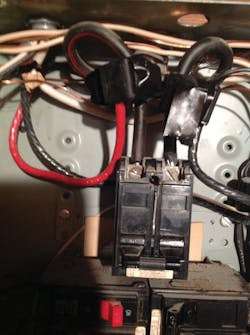

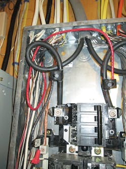

Section 705.12 contains the prescriptive requirements for interjecting power sources from the output of the electric utility interactive inverter into the premises electrical system. Section 705.12(A) deals with connections ahead of or on the supply side of a service main disconnect (Photo 1). The requirements here are simple, as the sum of any overcurrent devices for the power production sources cannot exceed the rating of the service. The rationale here is that although the service disconnect will limit the current provided on the line side, the power production sources will send any additional current out on the electric utility power system. Because of this situation, the available current must not be more than the conductors can carry. There is also a concern here relative to available fault currents that these conductors may be subject to.
Many people believe that PV systems can generate large fault currents like those found on electric utility distribution systems. That is not true, as PV systems are power limited. And, if the conductors are properly sized, they will always be larger than the maximum current that the PV system can generate. The real concern with conductors from alternative energy systems connected ahead of the service disconnect is the potential for them to be exposed to fault currents generated on the utility side of the meter. To compensate for this, language was added in Sec. 705.31 of the 2014 NEC to limit the conductor length to 10 ft (Photos 2 and 3). There is also an exception allowing these conductors to be more than 10 ft in length if they are protected at their point of connection to the service conductors by either cable limiters or current-limited circuit breakers. A first revision was made to this Section for the 2020 NEC, which moves the requirements to the new Sec. 705.11 and revises the overcurrent device location.

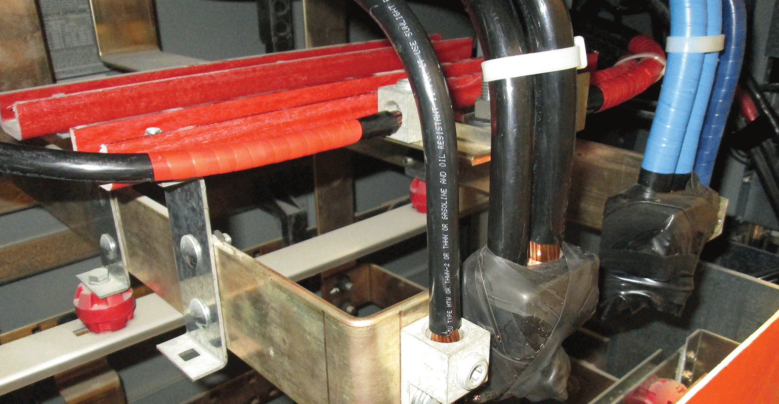

The other item to remember here is that many people are using power distribution blocks to make these connections (Photo 4). These are good products, but per the UL product listing (see OPQS), these devices are rated 1,000V or less and in systems with available fault current of 10,000A or less unless labeled otherwise. The product standard also recognizes power distribution blocks for use on both the supply side and the load side of the service disconnect. However, if used on the supply side, power distribution blocks must be checked and verified that they are acceptable for use at this point in the system.
Installers are also using a variety of insulation piercing and threaded lug type connectors to make these connections (Photo 5). My research has shown that this type of connector is covered under UL 486 A/B, and they are limited to use at 600V or less. It also has shown that there are no evaluations on this type of connector for limiting the use ahead of the service main or fault current ratings.
Many factors must be considered when using this type of connector, the most important of which relates to proper torque requirements in accordance with the manufacturer’s instructions. It’s also important that the manufacturer’s instructions be followed regarding the way the connectors are being used. Other NEC requirements to consider include wire bending space, splices, taps, and conductors in the cross-section of a wiring space within a panelboard not to exceed 75% of that area (Sec. 312.6).
