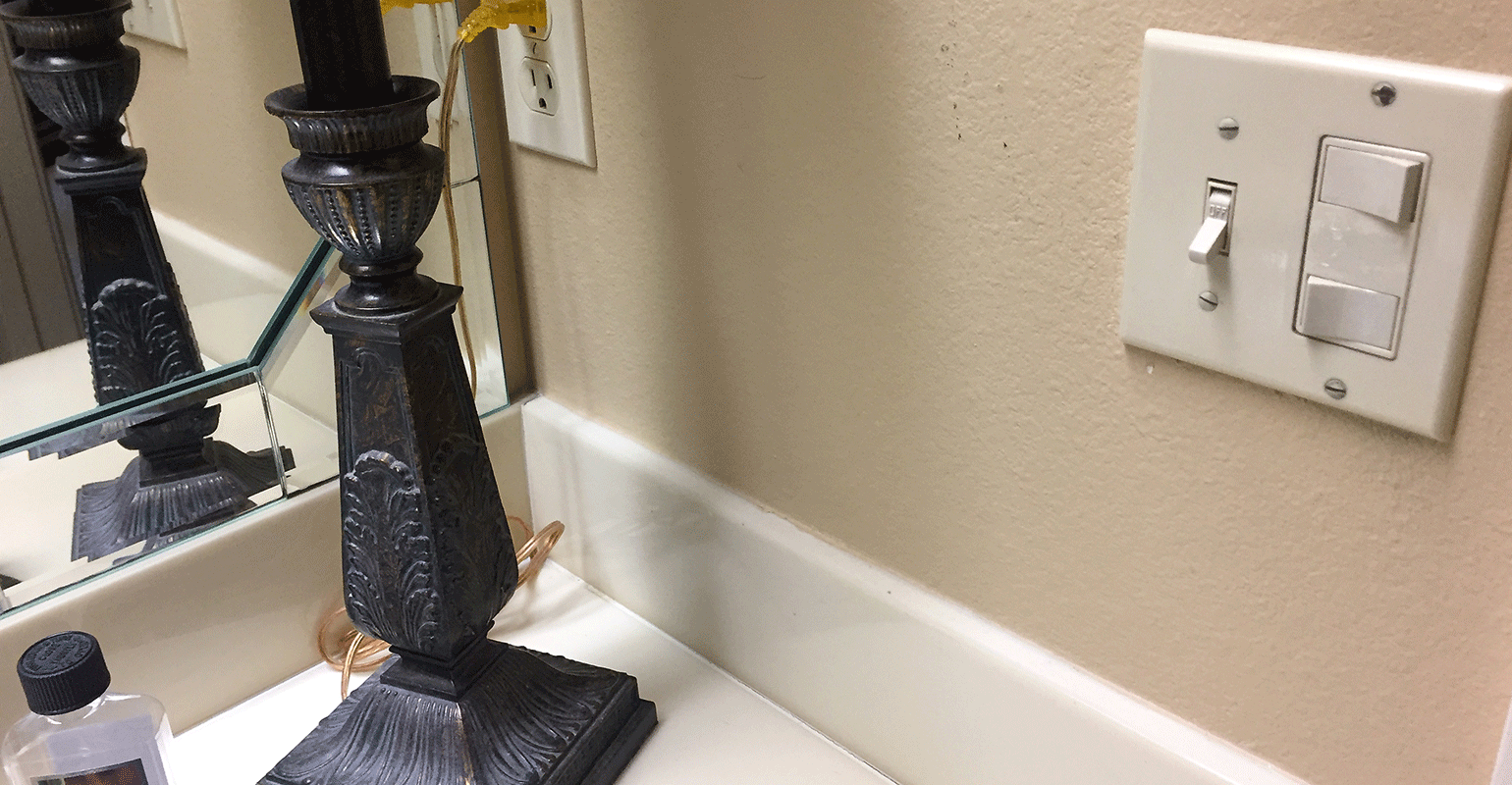

Let’s take an example of a homeowner who finds out the receptacle in the bathroom no longer functions (Photo 1 and Photo 2). The home, which was constructed in 1965, had been in the family for years. The family had taken great pride to make the necessary repairs during the life of the home to keep it functioning and in good condition.
The homeowner turned off the circuit breaker to the receptacle in the bathroom, had a voltmeter handy, and checked for the absence of electricity. With the receptacle removed and in hand, he was off to the hardware store to find another receptacle. After finding an identical receptacle, he installed the unit and turned the circuit breaker back on. The lamp on the counter was plugged back in, and everything appeared to be back to normal.
In the homeowner’s mind, the repair had been completed safely and in a Code-compliant manner. But is that true? In this case, that answer is no. After the DIY installation, the homeowner knows the receptacle is working properly but is unaware it needs to be GFCI protected to be compliant with today’s NEC. See Sec. 406.4(D)(3) in the 2017 NEC for GFCI receptacle replacement requirements.
The following week, a hair-dryer falls into the sink full of water in the same bathroom, and the homeowner’s daughter receives an electric shock. Upset, he drives to the hardware store, complains to the manager, and is told that store policy doesn’t allow employees to inform customers on how to perform electrical work or of the need for such devices due to liability concerns. Had the homeowner been aware of the need for GFCI protection, however, he would have purchased a GFCI receptacle. He simply put back the same receptacle and assumed everything was safe.

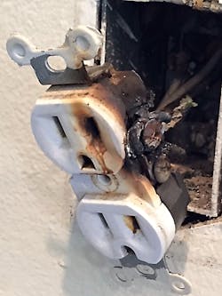

This real-world lesson reminds us that the more we can do on our end to educate homeowners in electrical safety, the better off we’ll all be in the end. Take every opportunity you can to help educate your community on the benefits of electrical safety devices, such as GFCI devices. As electricians and inspectors, we cannot stop learning about changes in the NEC. If we do, we just might find ourselves in a similar situation to the homeowner — where we’re not aware of critical changes that occur in each updated edition of the NEC (Photo 3). Therefore, what we think we inspected or installed safely and in compliance does not measure up.If you would like more information regarding electrical safety for dwelling units, please contact your local inspection jurisdiction. Many jurisdictions are happy to assist you with the current Code requirements. They can also provide you with information as to if an electrical permit or inspection will be required for the work you’re going to perform for your customer.
