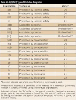

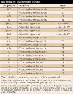

Table 2. One effective way to use this table is to look only at rows that contain your Zone or a lower Zone number. For example, if you have a Zone 22 application, you can use any of these techniques. But if you have a Zone 0 application, you need look only at the four Zone 0 rows.
Here’s another curiosity. If you compare the 10 protection techniques [506.8(A) through (J)] to the NEC’s Table 506.9(C)(2)(3) [Table 2], it seems something doesn’t add up. But things aren’t always as they appear.
Table 506.9(C)(2)(3) addresses the markings that must be on the equipment, as noted in the text of 506.9(C)(2)(3). The actual techniques are listed in 506.8(A) through (J) and defined in 509.2. There’s more detail to discover on equipment markings, and we’ll get to that shortly.

In Zones, you can use equipment that’s marked for Division use but equipment also must be marked Zone 20, 21, or 22 as applicable [506.9(C)]. In addition, it must be marked with its temperature classification per [506.9(D)].
Equipment meeting any of the protection techniques described in 506.8(A) through (J) must be marked with the following items in the order shown:
• Zone.
• Symbol “Ex.”
• Protection technique shown in Table 509(C)(2)(3).
• Temperature classification in Degrees C (preceded by T).
• Ambient temperature marking per 506.9(D).
