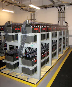

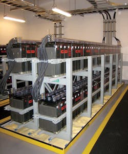

Photo 3. Example of a vented lead-acid battery setup in a data center.
Battery installations must comply with 480.9(C), which references 110.27 for guarding of live parts. Minimum clearances are indicated. Additional clearances should be considered to enable access for rigging equipment used during future battery replacements (Photo 3). Battery rooms may also contain emergency showers, eye washes, and spill containment, all of which should not encroach on the dedicated equipment and working spaces.
