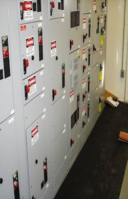

    A typical distribution substation with 480V motor control center.
    For distribution substations, many times the medium voltage feeds step-down transformers outside the building or enclosure of the substation, which, in turn, feed switchgear or motor control centers (MCCs) with a reduced voltage inside the substation. Many times, these systems are double-ended with more than one source feeding the substation equipment. The result is there are many instances in industrial plants where the distribution substations do not have one centralized disconnecting means for a substation. In fact, in many large substations, it is possible to have a dozen or more sources entering the structure or building. So, the question is: Does this violate NEC requirements?
