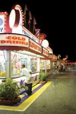

Most carnivals and fairs consist of portable structures, which require greater-than-normal clearances (Robert Ranson/Hemera/Thinkstock).
