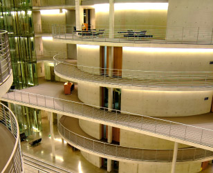

Lighting can be a large part of any building's electrical load — 30% or more if it is heated by non-electrical means. As an energy cost-cutting measure, consider upgrading your lamps from incandescent to compact fluorescents (CFLs) or switching from T12 to T8 fluorescents. You may also be motivated to look into a lighting upgrade based on complaints from your staff about poor color rendering, flicker, and glare. Announcements about legislative bans that will make incandescents, T12 fluorescents, and mercury lamps obsolete may also push you in that direction. Although all of these factors are valid reasons to pursue a lighting retrofit, if you're not careful, your project can lead to overheated transformers and nuisance tripping of overcurrent devices, overloaded motors and neutral conductors, and premature failure of power factor correction capacitors.
Total harmonic distortion (THD) can drop or dramatically increase following a lighting retrofit. That's why it's critical to reduce THD at the source (clean load) to prevent interactions with your building system (Promoting Power Quality Prowess on page 15), instead of creating power quality problems that have to be solved by installing very expensive filters.
