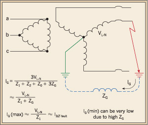

Fig. 1. Direct or solidly grounded system showing phase-to-ground fault and ground-fault current path. The NEC requires ground-fault protection on services of more than 150V to ground, but not exceeding 600V phase-to-phase, for each service disconnect rated 1,000A or higher.
With the solidly grounded system, as shown in Fig. 1, there is no intentional impedance in the neutral-to-earth path. Instead, the neutral is solidly connected to earth. This is why the term “earthing” is sometimes used in place of “grounding.” The phase-to-ground voltage remains constant during a ground fault, and there are very high fault current flows, which can result in extensive damage. The protective device closest to the fault must trip and isolate the circuit as fast as possible. If the fault is in a rotating machine, then there is a high possibility of core damage and replacement costs. The cost associated with the downtime also can be significant.
