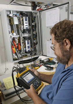

You can find significant energy-saving opportunities through load balancing and load scheduling when using power logging test tools. Whether conducting an energy audit or troubleshooting to find energy losses, a typical power logging session should record several factors, including voltage, current, power trends, transients, and event logs. Although analysis of each parameter is important in the overall
Although analysis of each parameter is important in the overall scheme of reducing energy costs, the focus of this article will be on reducing your energy bill by balancing loads across a 3-phase distribution system and scheduling the operation of certain loads to reduce energy demand. Therefore, we'll concentrate on taking voltage and current unbalance readings to determine load balancing issues and on recording power and related events to identify load scheduling issues.

Some makes of power quality analyzers and power loggers use a mathematical tool called the “method of symmetrical components” to analyze unbalance. This method not only simplifies the voltage imbalance concept by providing a graphical representation of unbalance in vector format, but it also provides accurate and detailed information to be used for analysis. Basically, these instruments split each phase voltage and current into three separate components: the positive, negative, and zero sequences.
The positive sequence component represents the normal voltage or current in a balanced 3-phase system. The negative sequence voltage or current is created by an unbalance in the system and results in overheating in inductive loads such as motors and transformers. This component is also responsible for reducing motor torque and can affect speed. The zero sequence component represents the unbalanced current that flows in the neutral of the 3-phase, 4-wire system. This results in energy losses in the form of heat in conductors and transformers.
The EN50160 power quality standard, “Voltage Disturbances: Voltage Characteristics in Public Distribution Systems,” (from the Leonardo Power Quality Initiative) sets the maximum unbalance at 2% at the point of common coupling (PCC), which is the ratio of the negative sequence component (Vneg) to the positive sequence component, or the zero sequence component (Vzero) to the positive sequence component. Neither value should exceed 2% (Figure on page 18). If these limits are exceeded, you should isolate and correct the source of the problem, or energy losses could become substantial. After a power logging session, download the data to a PC and analyze.

If you are attempting to more effectively schedule load operation, conduct power logging recording sessions to measure energy usage over time and identify large loads that operate concurrently. Use one-line diagrams to determine the energy demand of various loads and compare them to operating needs. Do not look for just one particular load as the culprit. Quite often, you must work with operations personnel and adjust a process by staggering cycling times, or complete certain processes during off-peak hours to reduce demand. You must also work together with operations management to review the electrical energy bill and compare it to collected power logging data to aid in making the best plant operations and energy cost savings decisions.
You should always begin monitoring at the service entrance to determine total energy usage. Set the averaging time in the power logger to 15 min. if that's the time used by your utility. (Consult with your utility to determine the actual averaging time, as 30 min. may also be used.) In addition, monitor power for an entire billing cycle of 30 days. This will provide the most comprehensive information. Consider repeating this on a seasonal basis, as power consumption requirements change.
Import the data to your PC upon completion of the logging session and search for periods where energy usage exceeds desired limits. Identify the equipment creating the peak demand charges by observing excessive uses of active power (kW). Finally, adjust plant operations and processes as necessary, to minimize demand charges.
