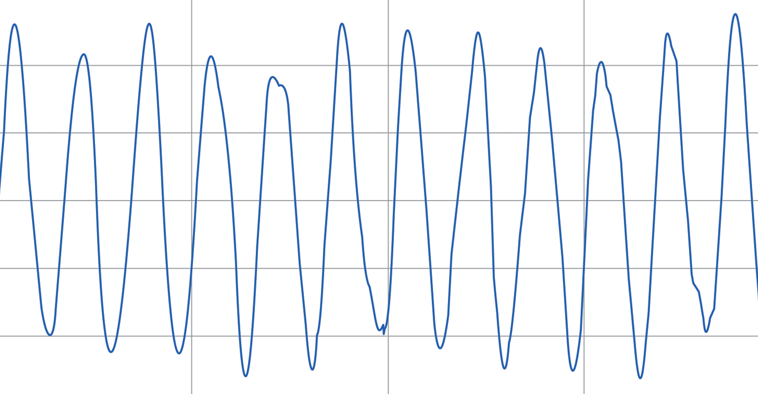

Figure 1 illustrates an example of a PQ recording from a 480V bus in a steel mill. Here, the voltage is scaled to a 1.0 per unit (p.u.) normalization, where 1.0 is equivalent to 480V. You can see that the peak voltage is most often affected. The shape of the maxima and minima, as well as the positive and negative slopes of the sinewave, are affected too, but not nearly as much as the peaks. Sometimes, the peaks contain significant distortion. However, you should also note the changing peaks seem to fit an “envelope” in the positive and negative parts of the sinewave to form a “boundary.” In fluctuating voltages, this envelope is typically consistent with respect to time and represents the fluctuating (or flicker) frequency. It typically ranges from 2 Hz to 25 Hz.
The fluctuating peaks are also typically non-destructive to driver electronics even though the peaks can reach levels as high as 1.5 p.u. This level is short-lived within less than a half cycle of the voltage. If such levels were steady state, as in the case of a voltage swell, the driver electronics on the front end would be damaged. In Fig. 2, you can see that voltage fluctuations affect amplitude (the peaks are constantly changing), frequency (a new low frequency called flicker frequency is added), and wave shape (the peaks and positive and negative slopes of the changing voltage is typically not a pure sinewave).
