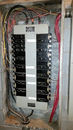

The Photo shows a 225A, 480V electrical panel (Section 1 in Fig. 2) downstream of the switchgear that also powers two VFDs at 480V. Note that these panels are grounded via their rigid conduits from the switchgear with no dedicated ground conductor. There is a second part (Section 2 in Fig. 2) to this panel, which is bonded to Section 1 via a short section of rigid pipe with locknuts. Rigid is much better than electrical metallic tubing (EMT), which has at least one EMT coupling every 10 ft. However, rigid pipe relies on threads that fit together with rigid couplings, etc. Over time, pipe threads rust due to moisture seeping into the threads. Many pipe threads have heavy oil residues left from threading which also act as barriers to good electrical connections to help establish low impedance connections between sections of pipe.
Also note there are no EGCs running to individual lighting branch circuits. Moreover, there is no grounding bar bonded to the panel. There are a mix of rigid pipes and EMT, leaving this panel to 4-in. junction boxes mounted on the ceiling and to lighting control panels. These missing EGCs add to the unmanaged risks of known electrical disturbances (i.e., voltage transients) occurring in this commercial facility, which were shown to cause permanent damage to electronic LED drivers mounted in fixtures more than 100-ft up on the ceiling.
The unmanaged risks are many, and the likelihood of driver failures needs attention. Hindsight shows us that the costs of proactive monitoring before LED lighting is installed is much less than the cost of cleaning up these problems after the fact. A recommended monitoring period of at least a week at different panel locations will provide limited but somewhat informative data, revealing the disturbances occurring on these panels. Two to three weeks of monitoring helps to capture disturbances from cyclical loads. Dedicated grounds to these panels and EGCs to each lighting branch circuit will help reduce the unmanaged risks of damaging new electronic LED drivers from disturbances caused by electronic switching in VFDs and from power system-level switching as well.
