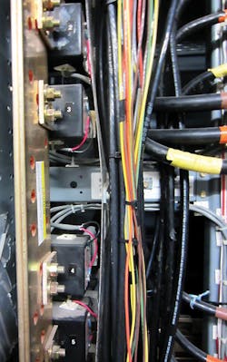

    Photo 5. Note the manufacturer installed current transformer locations. There is no neutral feeder connection on CT3. In addition, the neutral feeder to 3MP wasn’t moved from CT4 to CT3 when the phase feeders were moved to breaker No. 3.
    My search led me to an orderly layout of neutral terminals positioned in proximity to nearby breaker slots in each cabinet (Photo 5). I found neutral Terminal No. 12; it was without a neutral conductor connection — bare and unused (Photo 6). No wonder the microprocessor read zero neutral current. The CT associated with space No. 12 had nothing to sense! Where then, is the sub feed neutral from Panel 2MP connected?

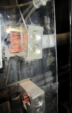

    Photo 6. Terminal No. 12 (where the neutral for 2MP was supposed to be connected) was bare.
    They say hindsight is 20/20. I had gained critical understanding that now aided me in this diagnostic endeavor. In removing the dead fronts of the switchgear, the problem was revealed (Photo 7). In fact, now it was clear as day.

    Terminal No. 17 has two neutrals connected to it, and they don’t derive from the same source of conductor runs. For Terminal No. 17 to have two neutrals, breaker space/breaker No. 17 would have to be a parallel sub feeder run. It was not, and that meant we had an illegitimate point of attachment — the neutral was  connected to Terminal No. 17.
    In short order I discovered that the additional neutral conductor was in fact a bandit from Panel 2MP’s sub feed conductors. The 2MP neutral had been randomly attached to terminal No. 17, probably out of convenience. Note from the picture that neither neutral conductor properly identified as such. Finally, the problem had been identified, and the explanation made perfect sense.
    Because Breaker No. 12 (Panel 2MP) had no sensed neutral current input, it was perpetually zero. Thus, as loads built up on phases A, B, and C, the unbalanced neutral load that the microprocessor expected was absent, resulting in only one possible interpretation — the presence of a ground fault. The microprocessor would then, as designed, electronically trip the breaker, open the contacts, and display the ground fault error message. In other words, the breaker was performing precisely as designed. The random trip instances were contingent upon the varying demand (on/off) of the zoned terminal unit heater loads serving the second floor.
    After de-energizing the breaker and properly marking the neutral, I removed the 2MP neutral conductor from Terminal No. 17 and connected it to Terminal No. 12. When I turned on the breaker, the display immediately indicated a load on the neutral, and the zero reading was gone.
