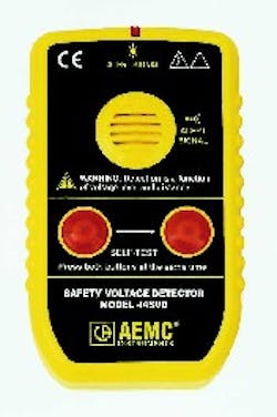

Designed to detect voltage 2.5kV and higher, the 44SVD personal voltage detector can detect 44kV from as far as 30 ft. As the detector is moved closer to the voltage-carrying conductor, its AC sensor plate picks up the radiated electric field, which is processed by the detector’s internal circuitry. Once the processed signal is above the threshold, it triggers the input of an integrated circuit, which turns on both a buzzer and LED. It comes with a pocket-sized case with a built-in clip.
