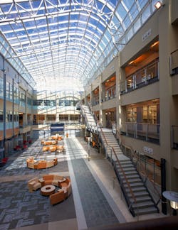

Contractors are breathing new life into historic buildings in downtown Winston Salem, N.C. Located in an area once known for its thriving tobacco industry, the structures are now being repurposed for art galleries, local businesses, and even high-tech laboratories (Photo 1). This urban renewal project, which is taking place over several years, includes the development of the Wake Forest Innovation Quarter, a hub for innovation in biomedical, materials science, and biotechnology.
Photo 1. Atrium area of this LEED-certified building.

Also, to meet LEED standards, the electricians installed quite a few refurbished and historic lighting fixtures throughout the space. Some 200 of the luminaires were installed in the atrium in the center of the building. It took three electricians to install each luminaire in this area, as they had to work from a basket carrier attached to one of the structural beams holding the glass structure in place.
